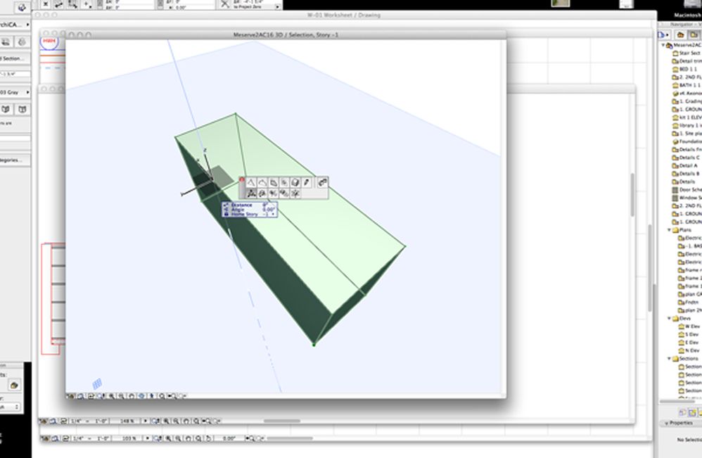

I'm trying to figure out the Morph tool, have watched all the videos, but I still can't seem to select a surface to push/pull in 3D (I can do it in plan view). I can select nodes and edges, but not the face of an object.
I'm attaching a picture of the only PET Palette I can get working with Morphs in 3D.
Am I doing something wrong??

No, sorry, that doesn't help. The first problem is that I can't select a face of the object- I can only select edges and nodes.
Here is what I am doing:
Creating Morph object (simple square)--> selecting Morph--> opening in 3D -->Selecting morph in 3D--> trying to click on the surface plane--> object unselects itself.
I've tried toggling grouping, hidden morph geometry... nothing works. I feel I am missing some critical step, but I can't figure it out.
There is a new sub-element selction method that lets you select edges and faces of Morphs. CTRL+SHIFT is the key combination for it.
Or, maybe the Options\Surface Snap menu toggle is not ON.
Lazlo- I tried both of those things, no luck. SO- I opened a completely new file with the standard AC 16 Profile, and everything works.
Something in my profile that I carried over from AC15 must be the culprit. I wasn't getting the little off-set square icon for my cursor. Any idea what setting I'm missing? Something in Work Environment (I looked but nothing seemed obvious to me).
Thanks!
