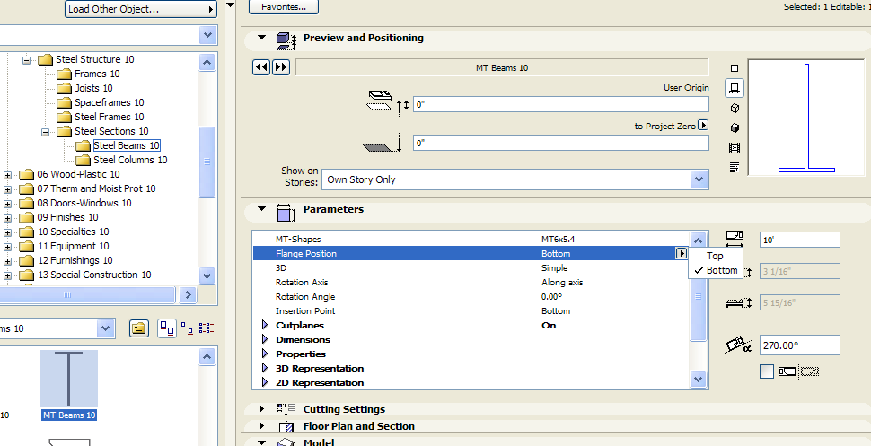

You can also change the flange to be on the bottom.
Brian
