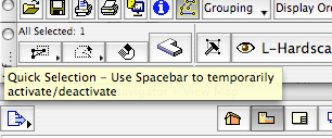

Stress Co_
Turn on "quick Selection"
It's the Magnet looking thing.
Awesome! You rock thanks!
I knew it was something simple.

Just use the Quick Select as marc suggested.
Also when in the arrow tool the space bar acts as a toggle for Quick Select.
So if it is off the space bar temporarily turns it on while you press it and if it is on the space bar will turn it off temporarily.
There was no need to delete your text either.
Once selected activate the text tool and then click on the text to edit it.
Or have the text tool active before you select but hold the Shift key to select the text then let go of shift and click on the text to edit.
In V10 the quick select magnet is much better as you can just double click the text to edit it.
Just hold space bar and double click if quick select is off (you must be in the arrow too to use quick select).
