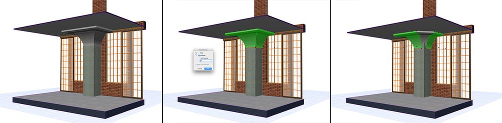

I am currently modeling specific column capitals using the complex profile tool. I have extruded 3 profiles in which I have then connected them in order to create a single geometry.
I need to chamfer just the outside corner of the geometry but I am having some trouble doing so. I have attached some photos to better explain my predicament.
Is there a way to chamfer just the outside corner? In the chamfer window there is an option to "apply to all corners" but I cannot deselect this option. Any suggestions? Thank you!

The Fillet/Chamfer is calculated from the Reference Line of the Beam, which is the Origin in the Profile Editor, but changing this (by moving the Fill relative to the Origin) will not help: the new Beam created when Chamfering will still be the entire Profile, not just the top part you need. Another approach is to convert the Beams to a Morph and edit the Morph, or divide the Profile into two parts: top to chamfer and bottom not chamfered.
