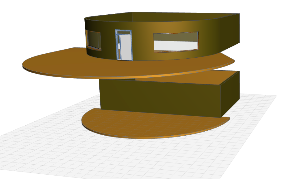

How do make it display correctly? Please see the image attached.

Check your story settings by right clicking on the view tab, then check you have each floor set up to display on the correct stories.

Scott:
One thing to try is to select the elements in the 3D Window, Right-click, and select "Relink Home Story" to move elements to the correct story.
David
David
