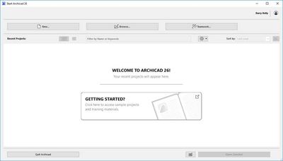

I was looking into this just a few weeks ago.
I found a file that can be deleted.
On a Windows machine it is …
C:\Users\user_name\AppData\Roaming\Graphisoft\Archicad 26.0.0 AUS R1
It is a file called … Recent Documents (Project).prf
I tried to just delete it, but if Archicad is not shut down, it will just re-create the list when you do shut the program down.
So shut down the program first and then delete that file.
You will see this when you start.
