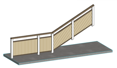

Hi there, has anyone in Australia successfully created colorbond fencing with an edit of a preset railing ? I don’t need a high level of detail except to show the metal sheet profile in the panel settings. How do I get a colorbond panel to show up in my railing panel setting ? A standard Bunnings fence kit with inserts is what I am trying to model up.
I do have “CI tools Coverings” installed so I might just draw a standard railing with a few edits and just clad the rail or even draw a wall and just add the colorbond profile to it ? If you have a better method please reply.

Another possible solution is to use 2 railings - one for the vertical posts and profiled infill, another for the capping that you use as a cutting body with upward extrusion.
In effect you could define everything in one configuration initially (posts, infill, top rail) create the path, duplicate the railing in place, and then delete everything except the top rail which you can slope, and use it for an SEO.

Results: 1st one is placing the CP panel in the railing manually. The 2nd one is with the CP panel saved in the library and applied to the railing as a panel. There is definitely gap and over shooting issues with the 2nd method when changing the spacing of the panels. Currently the panel is 2360mm wide and the spacing in the railing is set to 2400 because that gives the best results so far. It would certainly be good if the railing spacing could be set exactly to the width of the panel sheet and the railing showing no gaps or overshooting as below.
Edit: VW 2024 will cut a custom panel to size and auto step the fence. We need the same in AC as well please. See the video below for VW 2024.

Very good suggestion @Jim Allen, this time I just used beams and columns to represent the posts and rails. I like to keep the poly count low too.
Here is what I have so far.

You can do the whole thing as a railing and use the top rail as a cutting plane - it keeps everything parametric, and allows you to snap the top rail in the 'top cutting railing'.
You would have to add short stub posts in the cutting railing though...
