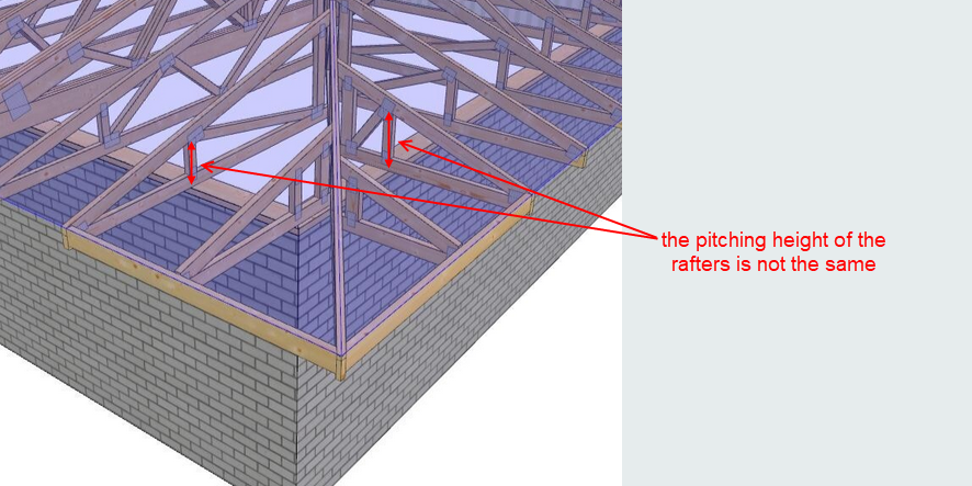

No this is not exactly correct that the only way is to shorten eaves. I have been doing structural design for the manufacturing of roofs for about 5 years (mostly trusses). This is a simple situation. You can have different slopes and ridges go directly in the eaves while both eaves are the same length. I am gonna put an example pictures with this post. It is not the same roof, but visually I need the same result. This ridge should move further away from the wall corner.
Archicad 28 Solo, Windows 11 Pro, Dell Precision 7560 Laptop (64GB RAM, i7-11850H, RTX A4000), Dual 27-inch Dell Monitors (2560x1440).
It can be done with the same eaves, but as Ling said, the pitching position or height needs to be altered
In your image you can see the pitching height is different.

Ok. Thanks, Barry and mthd. I understand that pitching height is different. Was just asking if Archicad can construct this kind of surface with more automatic tools. But I guess I have to do it separately then. Was working with Roofcon/trusscon and then Mitek Pamir. Those were very nice for designing roof surfaces and timber structures 😄
