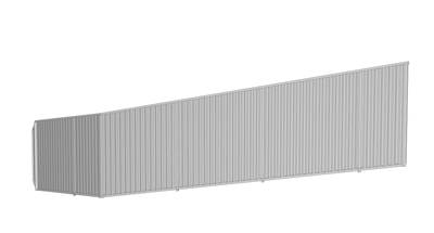

Hi there, has anyone in Australia successfully created colorbond fencing with an edit of a preset railing ? I don’t need a high level of detail except to show the metal sheet profile in the panel settings. How do I get a colorbond panel to show up in my railing panel setting ? A standard Bunnings fence kit with inserts is what I am trying to model up.
I do have “CI tools Coverings” installed so I might just draw a standard railing with a few edits and just clad the rail or even draw a wall and just add the colorbond profile to it ? If you have a better method please reply.

Without scripting a custom piece, it all just comes down to how small a single segment of your sheet pattern is and what gradient your fence is at.
It's not that difficult though is it - really?

Great job Jim to get the top of the fence to slope like that.

BTW I used a different method in this instance and made my CI tools do the work for me with the coverings tool. I created a thin invisible wall and attached the cladding to it and made a top and bottom rail appear with the coverings settings. Then I used the column tool to make the posts and the rest is history.

Hi all, I  have successfully transitioned from using the CI wall coverings tool with an invisible wall, to a railing with a custom colorbond sheet fence profile.
I need to taper the top of my fence down from 1.8m high to about 1.0m high. Similar to the picture that @Jim Allen, has provided above. How do I achieve this with the railings UI and how do I create a tapered top sheet profile ? (Without GDL of course)
Any help would be much appreciated.
Edit: I will try and use a tapered beam with a complex profile for the fence sheets to see if that will work or not ?
