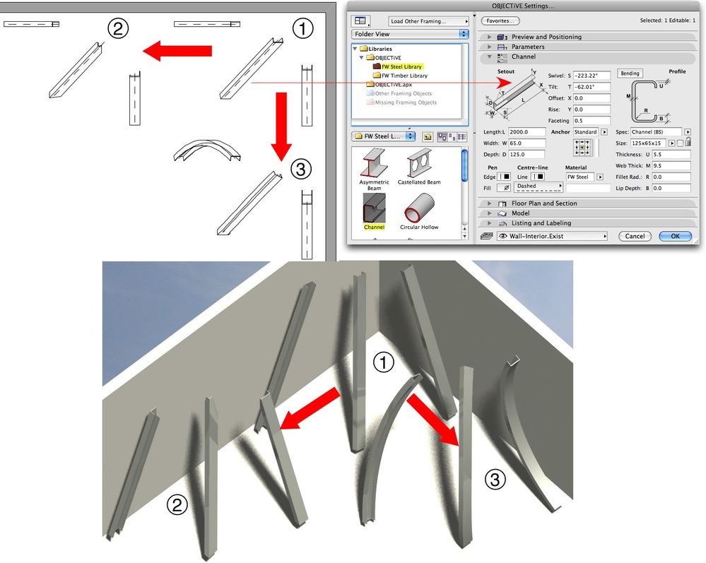

Hey y'all... I'm working on details that require a column (actually, studs.... but I'm using a custom profile and a column so's I can cut a section later) to tilt in two directions.
The big column constructed with steel studs (columns) and board and stucco is square in plan and tapered in section, so at the corners the studs need to tilt in both the x and y directions. When I've assigned a degrees-off in the selection settings, I can only get a mono-directional tilt.
Is there any way to get the studs to tilt at a diagonal instead of along a single axis?
Should I build this detail differently? Is there a more (steel) stud-appropriate tool I could use?

Can you simply rotate the stud on plan (ctrl + e)?
Use the bottom left corner of the main column as the rotational base point.
When I think about trying to frame that, I think I would do it differently than you are proposing. The square stud won't form the correct angle at the corner and will be difficult to cut and fit. I would be inclined to keep the studs parallel, let the gyp overhang to the corner and reinforce it from the back with angle (corner bead would do).
Even if it needs the full strength of a stud at the corner I would just rotate the stud 45° and slope it like a hip rafter. The idea of cutting a steel stud at a compound angle and fitting it to the tracks sounds like a mess to me.

OBJECTiVE has objects and tools for this purpose. I've attached a sample image with 3 groups of 3 studs manipulated in a variety of ways:
  • 1. Each stud is rotated in a different axis; x, y, and x/y (as you required)
    2. Also rotated, but compound cuts applied to the ends
    3. Rotated and bent to curves
I've illustrated the results in 2D and 3D, and the settings for the stud rotated in both the x and y axis are also shown to demonstrate the control you have over the objects.
The tools for rotating, cutting, and bending can be used in both plan and section/elevation, making it easy to assembly quite complex models. The steel library comes bundled with the add-on. For more info:http://www.encina.co.uk/objective.html
