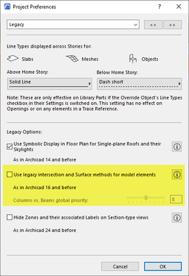

‎2022-05-20 03:49 AM
Does display order do anything?
Display order will only work if it is an old file and the Legacy option for intersection and surface methods is turned on - this is probably unlikely.
I don't think renovation status will have any affect (unless the column is set to be hidden).
My guess is still Building Material strengths.
Can you show an image of the Building Material strengths?
Select the wall and the column and open Building material settings.
Group by usage.

‎2023-03-21 06:49 AM
@Barry Kelly Any ideas what could cause this if not above? I have the same problem but legacy is not ticked and building material for the column is much higher than the wall.
Weirder for me still. When the column is behind the wall in a plan view it cannot be selected or found. When it first happened I assumed I hadn't accidentally hit delete, so I drew another and moved it in to place. I tried choosing the column tool and doing a select all, but it shows nothing in my selection. However, when I go to a perspective view, I can see the two columns and edit them. If the column sits out from the wall, I can select it, as soon as it is wholly within the wall it seems to not exist. Very perplexed.
All are on new renovation, there are no graphic overrides on, column has a higher building material priority, legacy intersection is not ticked.

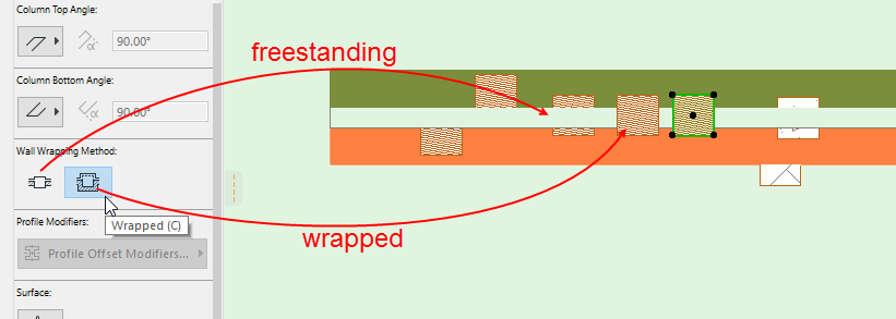

‎2023-03-21 07:08 AM - edited ‎2023-03-21 07:08 AM
The only time I am seeing the columns disappear behind the wall is when the building material strength is weaker and the column is set as 'freestanding'.
Still the column can be selected by its nodes.
When the column is set as 'wrapped', the wall will wrap around the column and it will always be seen.
