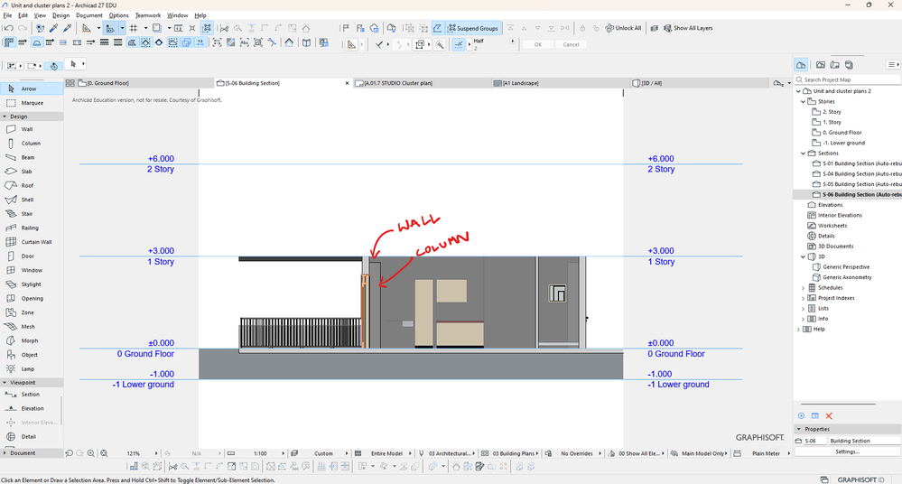

I have a wall and a column at the end. But somehow, the column height does not reach the top linked story even though the wall does. What am I doing wrong?
AbdullahChaus_1-1729422304325.png  Column settings
AbdullahChaus_2-1729422349356.png  Wall settings
The story height is 3 meters btw.

Abdullah Chaus:
In the Column Settings dialog box, look at the Top Link offset under Positioning, it looks like it is not set to zero.

Abdullah Chaus
Thanks David. That was it!
