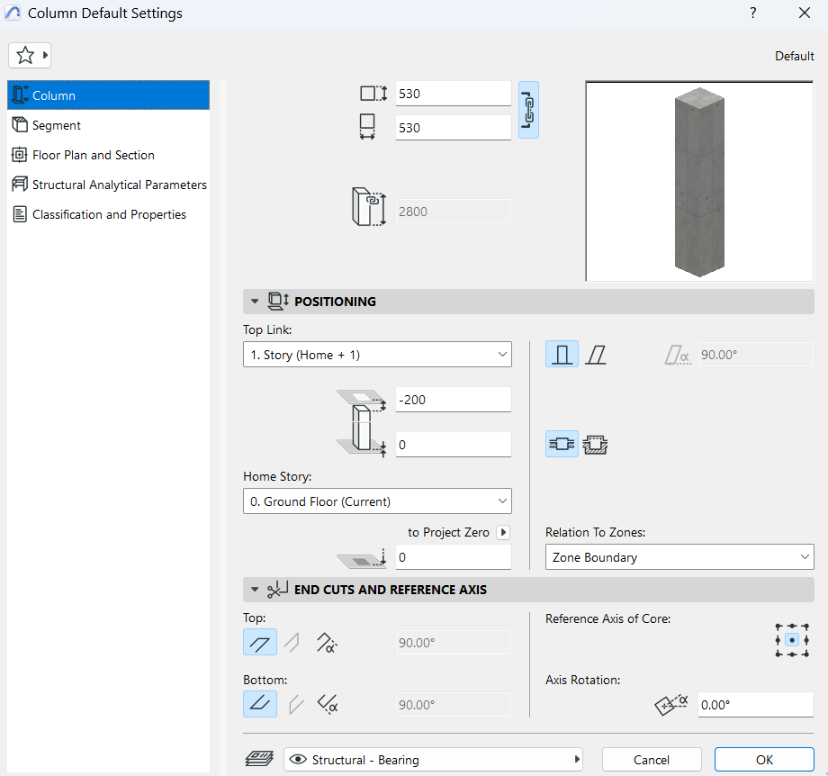

I have trouble to  Create Column with Grid system.
I use Design Grid System and use Element at Grid Line by Column. When i place Gris system the column is not in the centre of grid system. How can i fix it?
Please suggest for me please.

you might want to uncheck the “keep column and/or beam within grid perimeter” box. That should solve it.

CosminF that is help me a lot.
Thank you so much.
