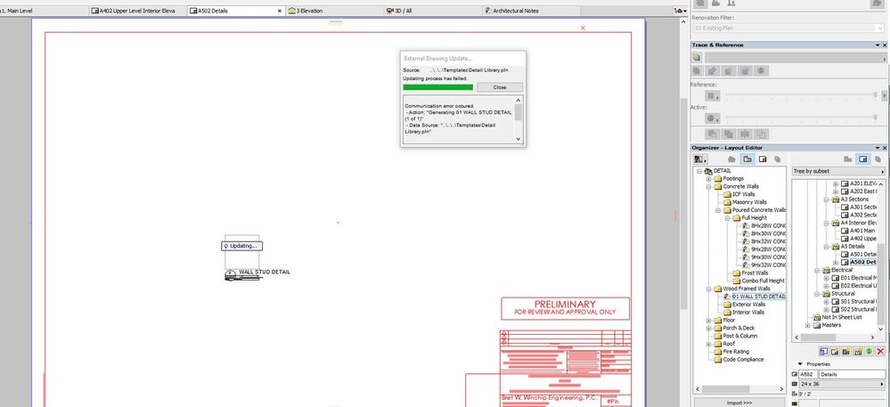

I am having issues with getting views from my detail project onto sheets in my actual projects. There is no Teamwork involved.
I made a separate .PLN file for office standard details etc. so that I can "drag and drop" onto sheets in my other actual projects. However when I do this the standard detail doesn't load. It tries to update and never finished.
The drawing update window says communication error
Any Ideas?

I know its been a while since this was posted, but I may have a solution which seems to have finally solved a similar issue I had.
I also use separate file to house all my details, and for some reason I was unable to get the external views to update even with the details file being open in a separate ArchiCAD instance.
My current solution was as follows:
  • Make sure all externally linked detail views are all set to "manual" update type (this is done in the details file). This is to avoid any issues of actually displaying view content. So in case of ANY issues, you'd at least have the last good view shown.
  • Initially copy over individual views or entire sheet of details.
  • Update any details by copying over a new, revised detail and delete current one.
For some reason ArchiCAD would not recognize the details drawing running inside a separate instance of ArchiCAD and just indicated it as (linked) in the Project Chooser. Whenever this was the case and the external drawing was not shown as (active), the update would hang and ultimately fail (image below).
Today I ran across a performance troubleshooting guide which pointed to the NVIDIA Streamer Service as a culprit for a different issue involving communication between ArchiCAD instances. But it finally seems to have solved my issue as well, which I believe is what you were experiencing.

I only just stumbled across this solution, but I've tried opening the project and details in different order, leaving one open and restarting the other, etc... and the details plan is now shown as (active) when its running, as expected, and update is working just fine.
Hopefully this can be of some help to someone
