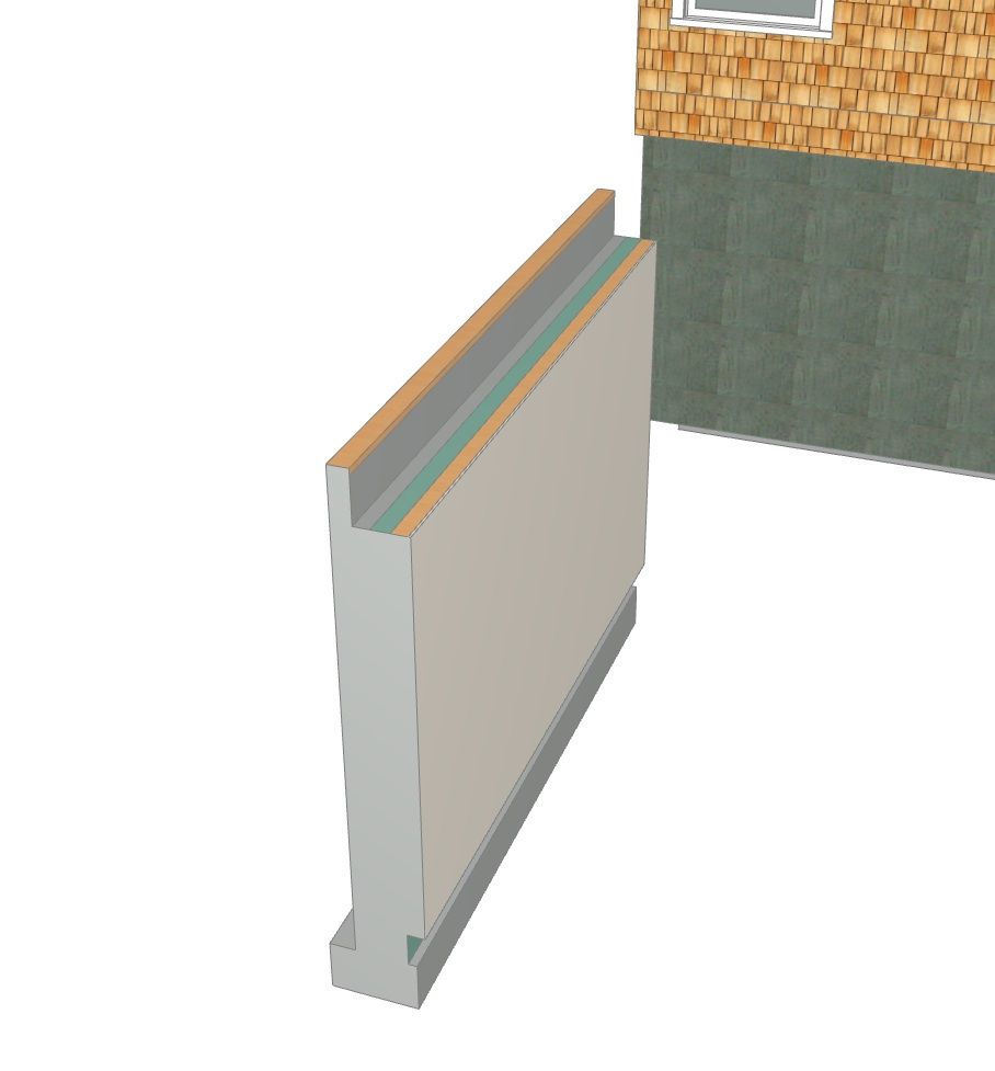

How can I make the attached complex profile wall have the same end profile as edge profile? Right now the whole end profile is ugly gray, I want each piece of the profile to have the same color/material as its edge. Is this doable???
5 Replies 5
Karl Ottenstein
Moderator Emeritus
Nope.
S.O.L. eh?
Dwight recently posted a clever technique for doing this at the end of this thread : -
http://archicad-talk.graphisoft.com/viewtopic.php?t=14945
Dwight
But unfortunately that slimy trick only works with surfaces, not internal faces.
However, a fellow might make a really thin column on the end face of a wall .......
Dwight Atkinson
Oh well, not a big deal, just thought it should be able to do that...
