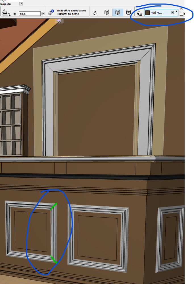

But the main problem I'm struggling with is marked below - I created moulding panels on a reception desk and I'm trying to change the material, but I cannot.
The chosen material is brown, but the moulding appears as white.
The moulding was created with beams and custom profiles, and then changed to a 'morph'. I know I could change the material in the custom profile menu by changing the core material, but these objects are no longer custom profiled beams; these are 'morphs', and I'd like to avoid going back and creating them from scratch.

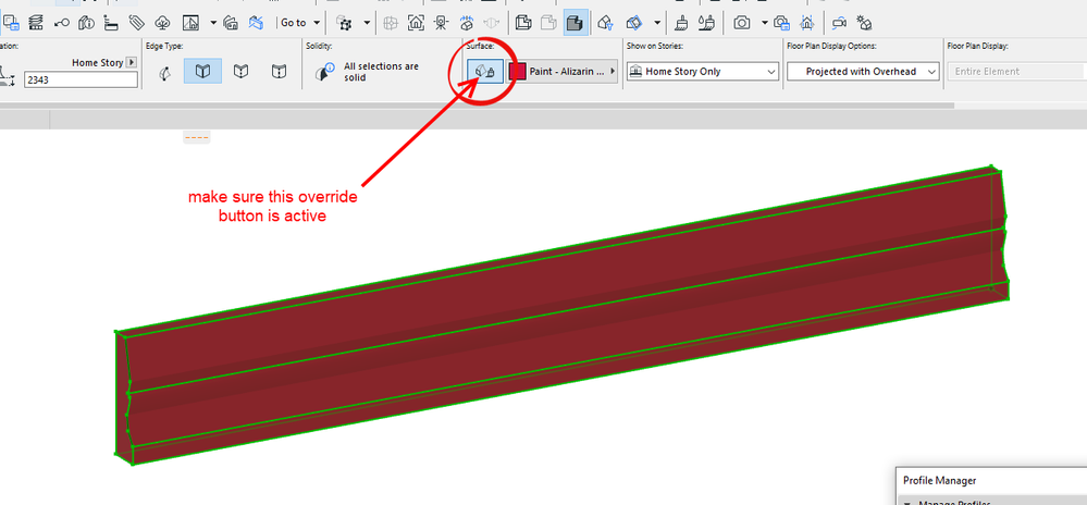

It looks to me like the material override button is not active.
The surface material should change.
kielbasa
It would have been too easy.
In AC18 there's no way I can press this button. I can't override material for 'morphs'

kielbasa
No.
I found in the other thread that I can sub-select surfaces,  open pet pallete and change its material there, but I can't do that either.
I can sub-select edges  only, not the surfaces. The magnet button is on....
