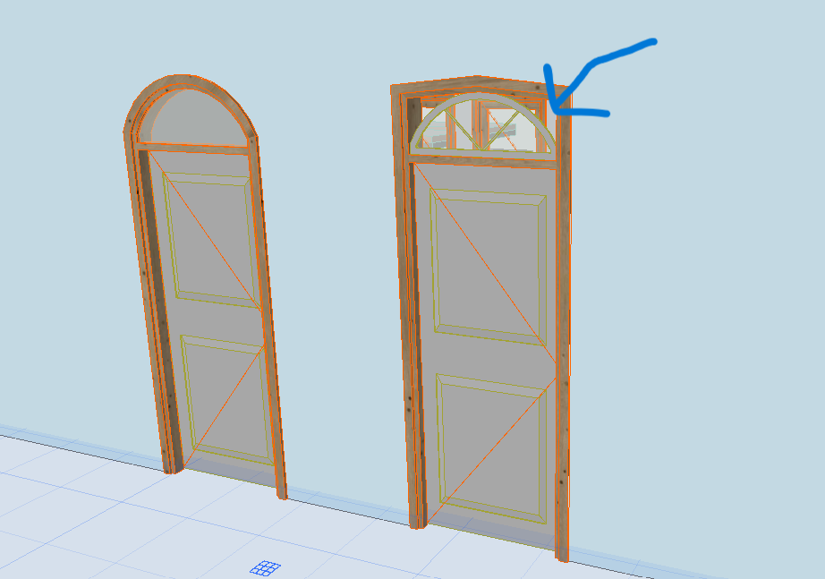

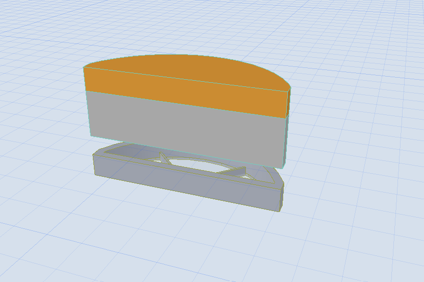

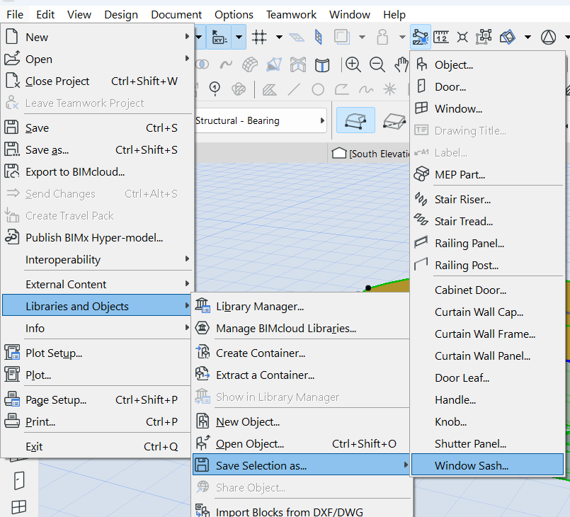

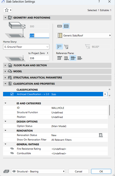

I have create a Custom Door Sash (By Morph) and create slap above Sash model (ID: WALLHOLE)
When i load to Door. Sash is have problem with hole and shape is look not correct as i create in model.
Please suggest for me to fix this please
Thank you for your help.

If I am not mistaken, the widow sash is just like the door leaf.
You do not need the WALLHOLE slab as it does not cut a hole in the wall.

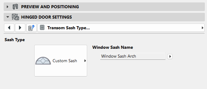

It simply replaces a sash or leaf in the door or window frame object, and will re-scale to suit the size of the frame (but not the shape of the frame).
You would probably need an arched door or window frame for that arched sash to work.
