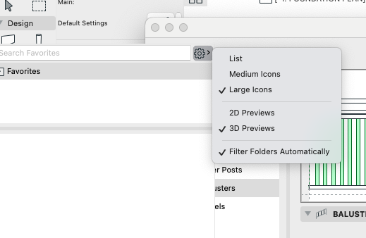

CFS_Mike
Don't have that option

You have to add Favorite pallete to the work enviroment (menu Windows > palletes > Favorites). There the import/export command will be available.
This command is not available in any tool settings.
