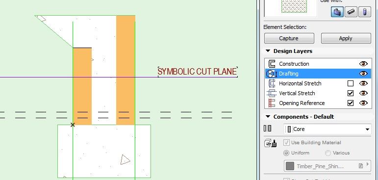

I want to add detail to my complex wall profile so I don't have to detail anything in sections. I am getting a space/gap in this Complex Wall Profile I don't want to see. It also makes a gap in the Skin Label. Apparently what shows in the Floor Plan view of a Complex Wall Profile is based on a pseudo cut through the wall at some distance above the point of origin in the Complex Profile Window. ? If so, what height is that, and can I control it to get rid of the gap I don't want to see?
I also make the Complex Wall Profile with siding because I like the way it give you a true 3D view instead of just an image of some siding.

It is the Floor Plan Cut Plane height that determines how the plan view appears.
This may also affect the output of your label - so if you can get the FPCP to be at a height were there is no gap then you label may be better.
I have asked Graphisoft in our developers forum if we can nominate the cut plane of a complex profile in the profile settings but there has been no response.

Thank you Barry much
That works. I just had to get a dimension on where from the point of origin up to a place where the cut through only one piece of the siding fill and where it was also tight to the wall sheathing fill. There was no place exactly like that so I stretched the siding fill a bit in that one place to make it work.
For those who may be interested, I also have a tiny sliver of fill/material in places where I want it to report two materials but I only want to show one.
The studs @ 16" o.c. and the insulation for example.
