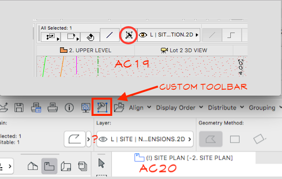

And you can still add the button to a toolbar - it is just not in the info box any more to give a bit more space to the layer name.
Stress Co_
I added it to a custom toolbar.
Located it just above where it resided in the pre AC20 infobox.
