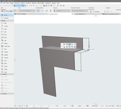

yes you're right beams can't do 90 degrees that's why they got coloumns. ðŸ˜†
for the morph tool screenshot below for your reference.
WINDOWS 11 PRO
You cannot set a Complex Profile as your reference within Morphs, so if you need to make changes down the line you need to redraw the whole element...

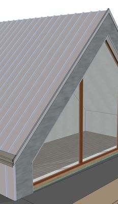

For example to make flashing of roof edge like this - I've done it with morph and division further with texture in twinmotion, I know i could do this as combination of column with beam. Still I'd prefer to make it as one or at least a combination of objects of the same type - just in order to keep it tidy - and eventually adjust it just changing the profile
