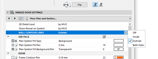

I have a door inserted into a complex profile wall, and for whatever reason, the plan is not displaying correctly.
I have tried all the different permutations of projected / symbolic for both door and wall. I have played around with the opening reference line - but I just can't get it to display right.
- With wall on Projected, and door on Symbolic: door symbol is correct, but in the wrong place, and wall isn't properly cut
- With wall on Projected, and door on Projected: door symbol shows as closed, with no swing line, but is shown in correct place, and wall is correctly cut
Is this a bug?

Might it just be the Floor Plan and Section settings?
Ling.
William Yan
Not this one I think.
