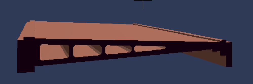

Depends on the shape of the slab (in plan), You could consider using a complex profile and a wall. Otherwise I think you're on the money.
Cheers,
Link.
Dwight
Like this - a wall with defined complex profile
