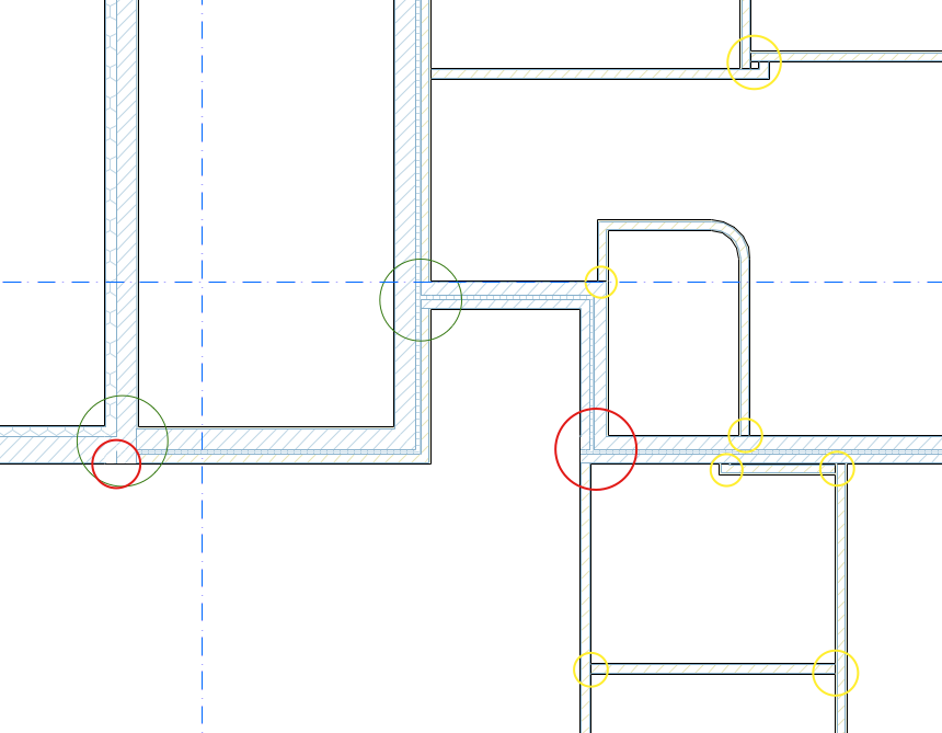

The composite walls, at some point of my AC17 session, just went wrong displayed. Both, own created and AC predefined walls shows only one component of the composite, it only happens in plan view and in all existing stories, the same wall looks correctly in section, elevation and 3D view.
Could it be a bug or could it be an activated feature that i did by mistake?

Is your Trace Reference turned on in images 1 and 3? Can you upload those again without the Trace? It is pretty hard to discern the lines with it turned on.
Could you also turn off the layers of any other elements and lines (like Structural Grid lines etc.) so we can see only the elements that need to properly intersect.
Could you also do that you place texts at each skin of the problematic connections and type in the text the Intersection Priority Number of the Building Materials assigned to each skin?
By the way, whatever you did in image 2 was getting you closer to the solution as the connections seem cleaner.
One thing I am thinking about is that you cloud try assigning a higher Intersection Priority Number to the Building Material of the plaster skin (this applies to the leftmost problematic connection of image 2). That may clean up that connection.
I think there can be cases for such connections that will not resolve properly, but the ones you are showing you should be able to set up so they join properly.
If I assign a higher priority to the plaster, I get much more faulty connections… in the example above I raised the plaster only above internal hollow brick… if I raise it more I'll get even more faulty connections.

I checked the file you provided in your post.
I have uploaded the version I modified to this location:
https://dl.dropboxusercontent.com/u/95654898/Project%20old%20version.pln
Please see the attached image. It explains the things I did to correct the joints.
OK for moving Reference Lines, ok for using Junction Order setting (thought it didn't have a role using material priority setting), but if I use pen 1 for Skin End Line, I got a lot of unwanted heavy sings in Sections… even in the views without showing the skins.

Unfortunately there does not seem to be a solution in which both you Floor Plans and you section will be correct.
What you are trying to do is set up Composite Pens so that you have a thick outline around you structures both in Floor Plan and Sections. But it seems there will always be cases when this setting of Skin End lines to Pen 1 will give results you dont want, especially in Section.
(You could actually make a wish for a separate setting in ArchiCAD to achieve this. I think it would make a good wish because in architectural representation we many time want to do that both in Floor Plan and in Sections.)
So I would suggest setting those Skin End Lines back to those previous colors. That way you Section will look fine. Then just use lines to get the desired result at the few places in Floor Plan where they don't give the desired result and group each surch line with its Wall so they are moved together in case of dragging the Wall. Sorry, I don't have a better advice.
