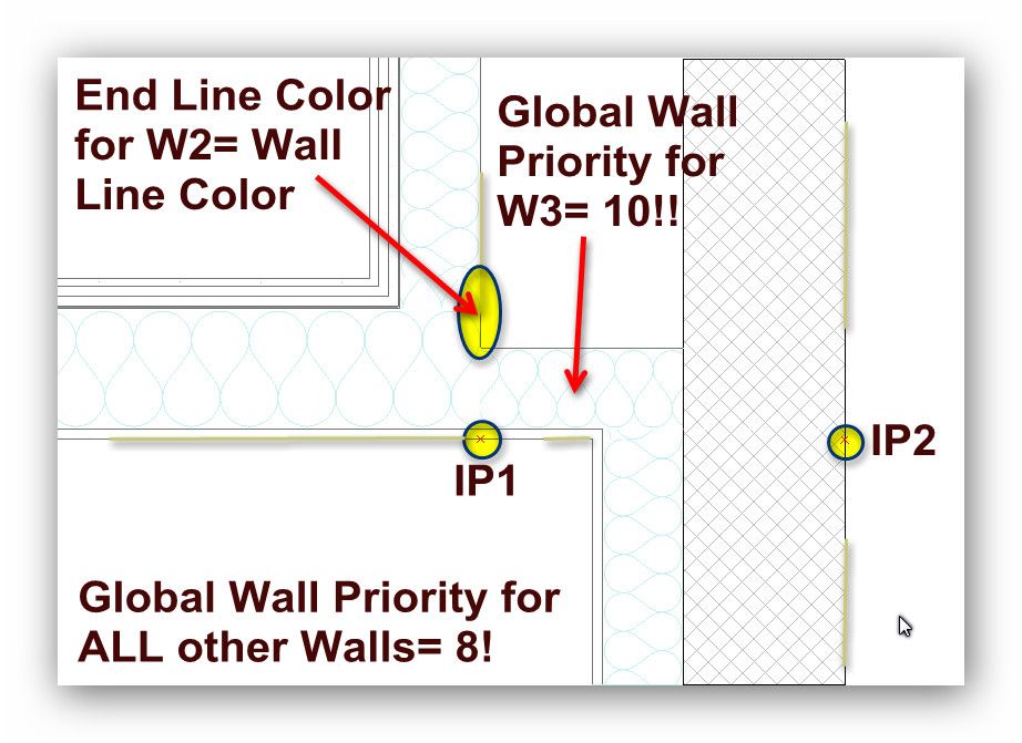

T connections are dificult. Try to set the Walls like that from my example.
andro55 wrote:
mentan,
Thanks, but what do you mean by "end line color" and "wall line color", IP stand's for what?
Settings for Composite Walls:
"end line color".....Skin End Line Pen
"wall line color".....Skin Separator Line Pen
IP..........................Intersection point for the Wall Reference Lines
