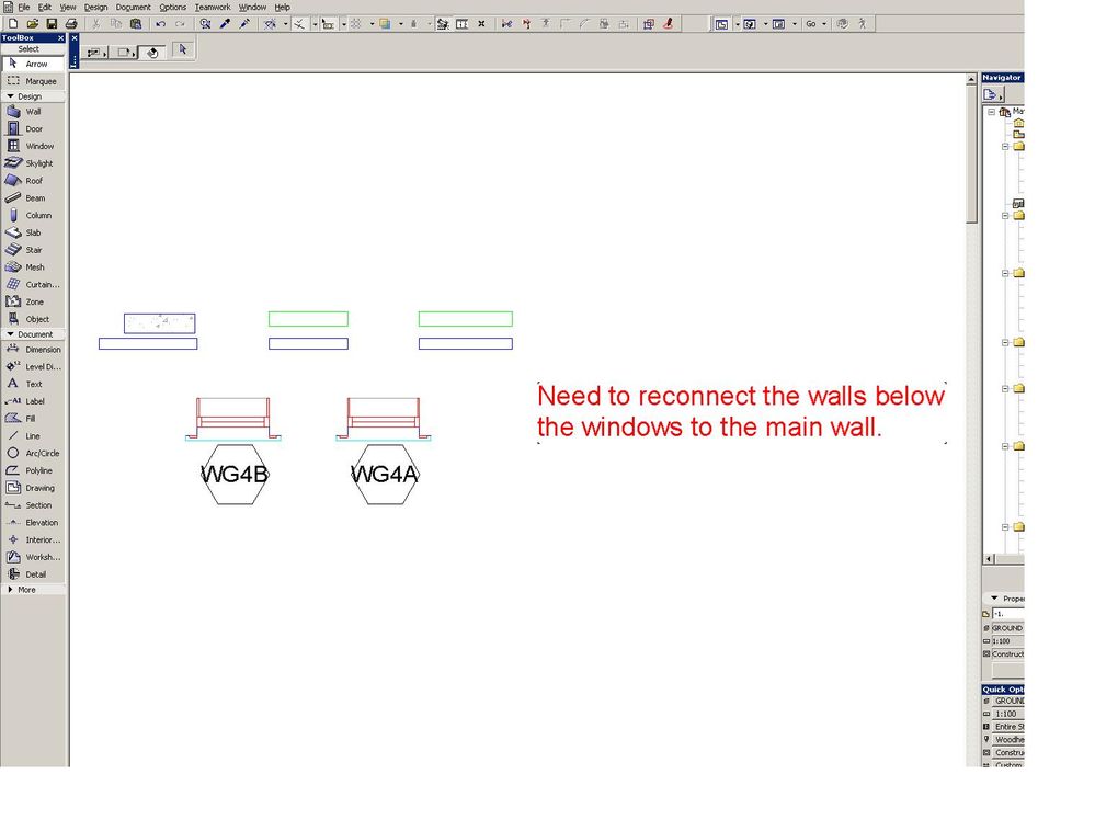

I have a small problem with the walls on my project. In an attempt to increase the depth of my window reveals I have stupidly cut the walls where the windows occur and then increased the overall wall thickness. I have since discovered that there is an option to increase the depth of the reveals within the cadimage settings (this is my first time using a plugin for doors and windows, I generally use the standard doors & windows).
Does anyone know a way that I can reconnect the walls without needing to redraw everything - similar to how you can join slabs together using the plus tool?
Any help would be much appreciated.
Thanks.

You can try:
Select the walls, then go to the main menu:
Design/Complex Profiles/Merge Walls
This will merge the walls, capture their composition (cut fills) and make it a Complex profiled wall... which you can change back to your desired Cut Fill or Composite.
Hope this helps

Thanks heaps Nando. That's awesome.
