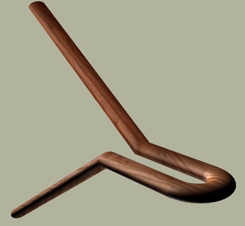

You could include a landing in your stair that would have the same railing.
Making your own railings is so easy with ArchiCAD that I never use the ones generated by Stairmaker anyway. Learning to do this is fun and you will never have to worry about the kind of problem you listed above.
What does the stair railing you want look like? I will send you an example of how to make your own if you like.

Could you plese show me the way you create your own railings?
It sounds interesting.
Thank you in advance
Steve Jepson
At the risk of posting redundant informaion (again--sorry)
see if this link gives you as much info as you need to make the custom handrails.
http://archicad-talk.graphisoft.com/viewtopic.php?t=3350&highlight=curved+handrail
If not I would be glad to show you now I do it. Be sure to click on the picture below to see it in detail.

You know... one of the things I love about ArchiCAD is that no matter how long you've been using it there are some things you just never think of! I've been using ArchiCAD since 1987, when it first came to the US; I think profiler has been around since TeamWork (5.5) and I use it for many things but I've never used it for a railing. I certainly will in the future.
I have, however used TrussMaker for railings and I can see that with a combination of profiler and TrussMaker you could do some amazing railings.
