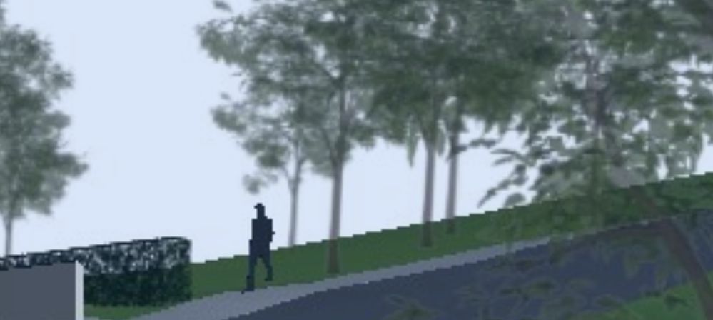

Hello Archicad users,
I just merged a project from AC24 to AC25 and noticed the resolution of my 3D image changed (see the photo attached).
A few years ago, I did have the same problem and don't remember where the setting is to make the edges look like a straight line rather than a sum of short lines.
Thanks in advance for your precious help.

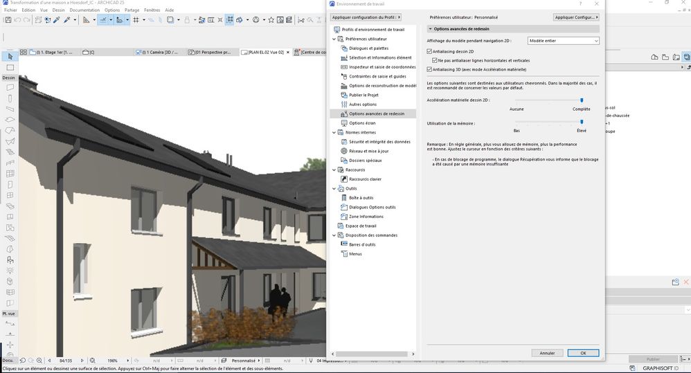

I think you are after the Work Environment > Advanced Redraw Options > 3D OpenGL Antialiasing.

Hello Barry,
Thank you for your answer.
I did check the Antialiasing 3D but nothing happened...
Do I miss something?
Thanks a lot.

It is ok now, It didn't refresh automatically on the layout page.
What you suggested helped indeed.
Thanks a lot and have a great day!
