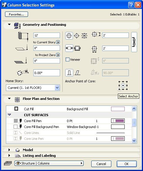

Anyone know why I do not have the option to change the core lines pen for my columns? See shaded Core Lines in attached image.
Working in AC13 now creating a mock project to see how the tools work/function in 13.
3 Replies 3

It is a minor fault in the template. Switch to complex profile and then back.
Straaaaange....It worked, thanks! Just like the single cabinet in v12 where you have to change the sink to round in order to have it smaller than 18 inches or so.
