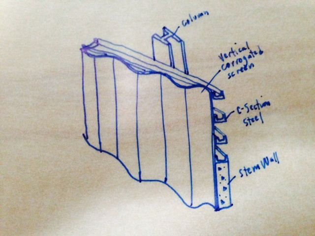

I'm struggling trying to make a wall with a vertical corrogated metal rainscreen. There's a 6' concrete stem wall with c-section steel spacers that the rainscreen is supposed to attach to. I can draw the concrete wall and spacers with the complex profile just fine, but how do I draw the corrogated metal rainscreen in the vertical direction? In the complex profile, the section would reflect just two vertical parallel lines (inner corrogated curve line, and outer corrogated curve line).

I'm trying to achieve the attached result, minus the column. I'm not using it for rendering. Does this help? I appreciate the responses btw.

s2art gave you the best answer. Since complex profiled walls only extrude horizontally, that won't help you. The cadimage accessory ($$) is the only clean solution. Using the metal object from the library would require you to cut the holes for windows/doors/etc and handle corner situations... which can be more easily done by sizing the object and converting to a morph (or just creating a morph) ... but the result will not be dynamic if your design changes, requiring a lot of manual re-editing. The cadimage accessory will dynamically adjust as your walls and openings change.

In Archicad 16 or earlier just assign a fill to the material (or to a "surface" in AC17 I think) consisting of vertical lines at the required spacing to represent the corrugations in Elevations. Have Vectorial 3D Hatching turned on in Elevation settings. In my example below my lines are at 80mm centres.
