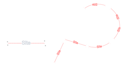

This is possible or not to create property line like this image.
Thank you so much for your help.
2025-12-03 11:00 AM

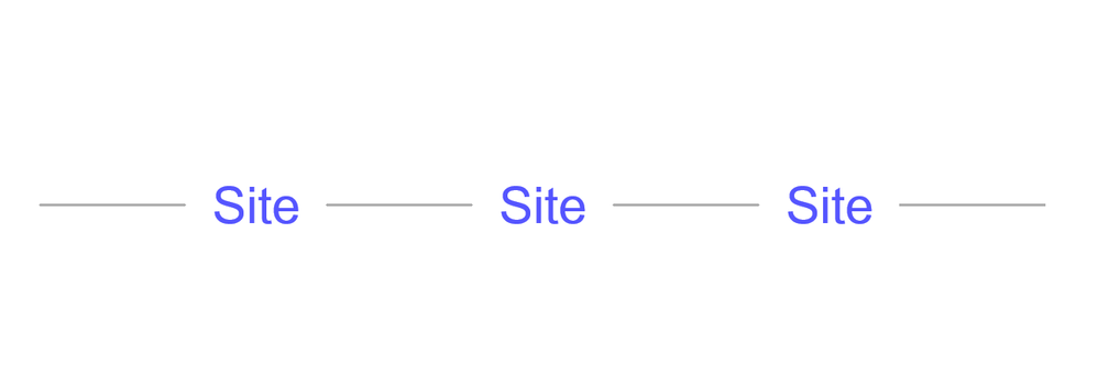

Yes, but only if you use lines to "write" the word Site.
Easiest way to do this, in my opinion, would be to get a 3D text, write Site, grab the fills/ lines from there (in 3D Axonometrical view). Paste them into a layout (so the "explode") as lines and fills, and then define a new symbol line around that.
2025-12-03 11:47 AM
You also have this french object: https://www-bimservices-fr.translate.goog/le-blog/assistance-a-la-maitrise-d-oeuvre-bim/generateur-d...
2025-12-03 11:52 AM
You could also try my object that I have done some years ago (doesn't support arcs, but they rarely (never?) happen with site boundaries tho).
