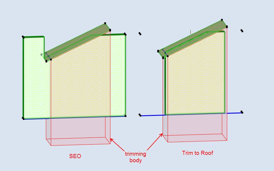

As Rogerdodge said use SEO (Solid Element Operation) to trim your wall.
This will only trim the portion directly above/below the roof.
If you use the connect > trim to roof command it will use the roof trimming body to control the cut and anything inside/outside the trimming body will be removed.

It is pretty simple.
Model everything first (i.e. walls and whatever you want to use to trim them with).
Open the SEO tool.
Select the wall and press the "Get Target Elements" button.
Select the roof (or what you want to do the cutting) and press the "Get Operator Elements" button.
Now choose how you want the cut to happen - subtract or subtract with upwards (or downwards) extrusion and then press the "Execute" button.
You can select more than one target or operator at the same time so you can trim a hole bunch of walls with as many roofs (or other elements) as you want.
It is a 'live' connection so as you adjust the target or operator elements, the resulting SEO will adjust automatically as well.
Hide the operator in a hidden layer if you don't want to see it - you can't delete it because there will be nothing doing the cutting any more.

Yes SEO only happens when the elements intersect.
If they don't intersect they will not be extended - but the SEO is actually still in effect - you just won't see anything.
For example if the wall is below the roof the SEO will have no effect.
But adjust the wall height and you will now see the SEO.
So you have to manually extend the elements yourself.
You can tell if an element is part of an SEO when you select it.
You will see a small square icon that you can click on to see a list of trims.
They can be cancelled by clicking the cross at the end of the name.
Also the effect of an SEO will not be seen in the plan view.
i.e. the wall may trim in 3D but will not show that trim in plan.
