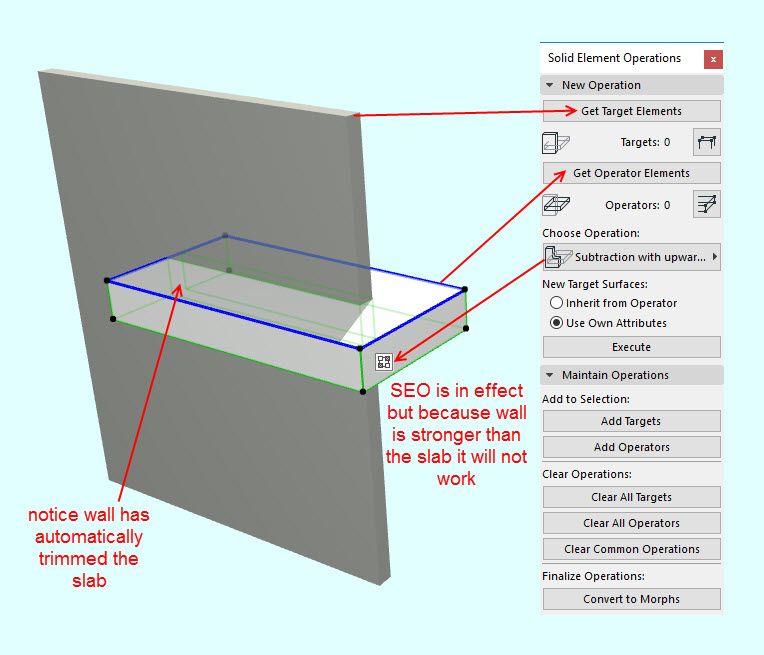

So long as the projection of the operator (i.e. the 'zone') intersects with the target then the SEO will still happen - even if they are separated.
Only the standard 'subtraction' or 'intersection' requires the target and operator to physically intersect.
Just to complicate things a little bit you have to be careful of the Building Material strengths for elements that automatically connect.
i.e. if you are trying to SEO a strong wall to a weak slab it won't work if the wall is the target and the slab is the operator.
The weak slab will automatically be connected to the slab creating a hole in the slab.
Because of this hole there is no slab to create the SEO with the wall as there is no intersection (or projection).
The SEO will be active but nothing will happen.
Make the slab stronger than the wall and it will now SEO properly.
(see attached image).
