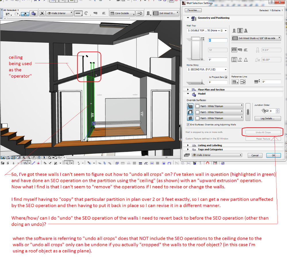

here's the scenario.
I have walls that I've done a SEO operation with to a ceiling object (it's a roof object being used as a ceiling).
Now, I thought "cropping walls" and an "SEO operation" can be 'undone' if you will, but I'm getting these "greyed out boxes" under the "undo all crops" when I select the walls.
What gives?

Rob, you did an SEO not a crop, thus the undo all crops is not active.
Notice the small blue box with four smaller boxes inside it in your image. Click on that box which will bring up a list of SEO operators that you can undo one at a time or all at once.

ahh...the "small box with the 4 squares"...ahh, yes I always seem to miss that little detail 😉
thanks, I'll try that.
