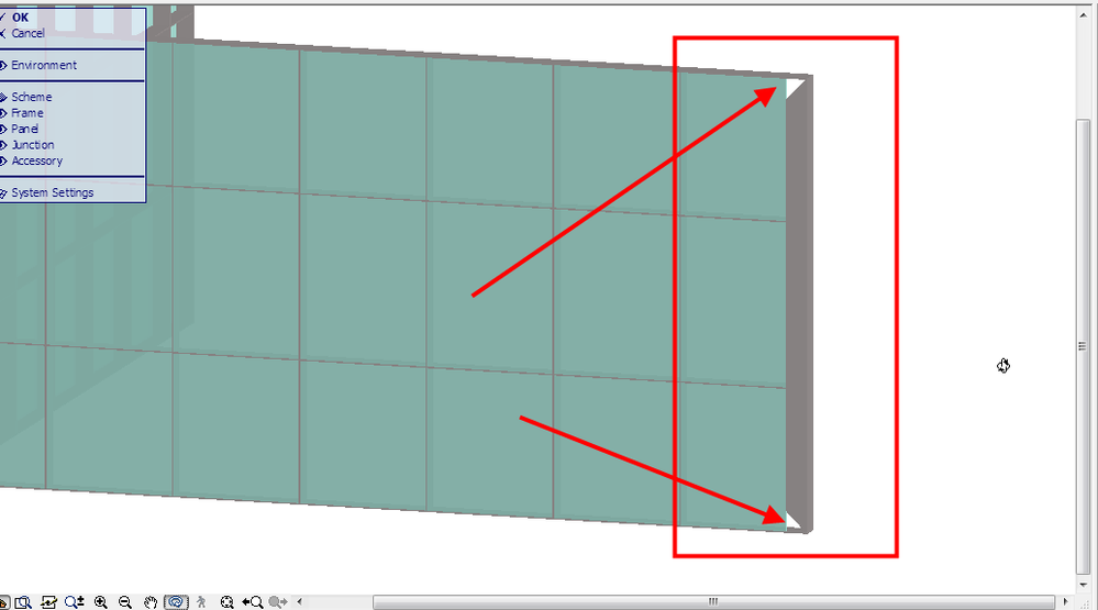

I need the Vertical Boundary Frame of Curtain wall to be thick while the Upper & Lower Boudary Frame to be thin. While doing so in Editing Mode the Connection of Boundary doesnt comes neat (See Image). Pls Suggest the possible solution!
Also Corner Panel option is not available in my Curtain Wall Library!

Try adjusting the Frame Intersection Connection Priority of the selected vertical frame, it needs to be different than the horizontal members.

Thanks David - Its working!
