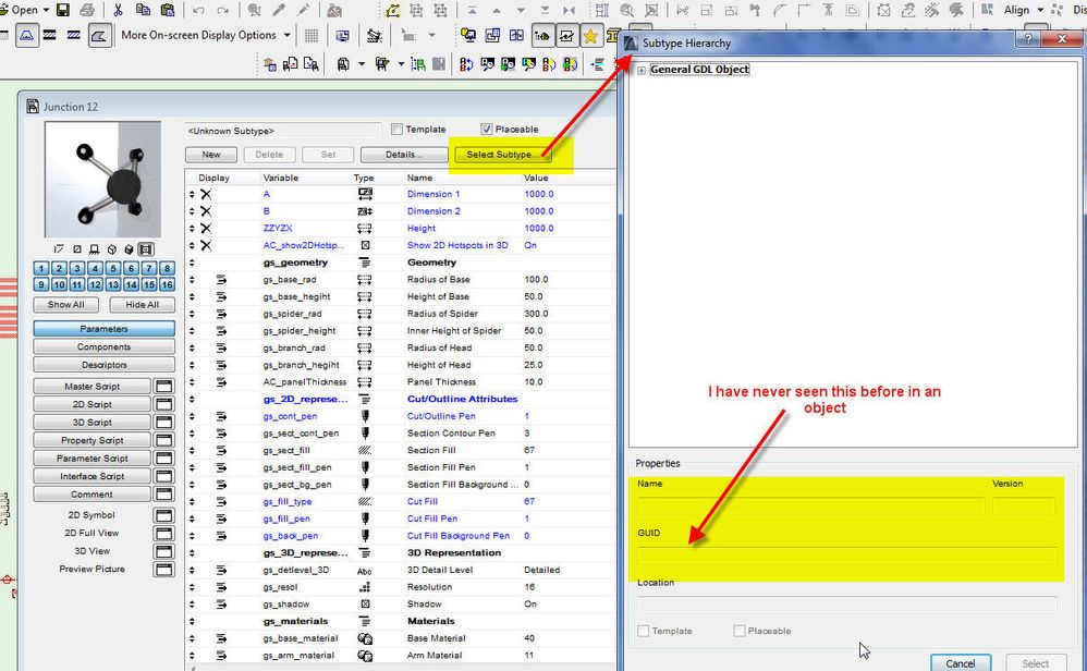

Im using Archicad 15 and seem to be using the curtain wall tool a lot in most of my models.
The standard junction that comes with the curtain wall tool, as adequate but recently im starting to require custom junctions for our visuals (mainly spider fixings on glass systems) Ive tried creating a custom spider fixing out of slabs/walls etc (not GDL as this is to complex) and saving as an object. When I try to use this within the curtain wall tool, within the junction window, it says this is not a valid junction file.
How do I create a a custom junction, and what file name/extension do I need to give it, so archicad will use it as a custom curtain wall junction.

I was going to say it is probably the object "Sub-type" that determines what it is.
But I just looked at one in my library and it has no sub-type (or GUID) at all.
I haven't noticed this with any object before.
And I can't see a sub-type for a CW junction either.
Does your existing junction part show a subtype and GUID?
This is a version 12 part that I opened in version 14.
Maybe it is just a problem with those parts - I will load the default library and check again later.
As a test though I just "saved as" an existing junction part with a new name in a totally different section of my library and it still found it as a new junction part straight away.
Ceate a new object from scratch and it is not seen as a junction at all.
And you can't even choose the option to "Load other curtain wall junction" to load it.
So without further investigation I am not sure how it is tagged as a junction object.

It is the object subtypes that controls the availability of junctions, frames, etc.
Now I have the default library loaded the subtypes are working correctly.
So the object you want to save as a junction will have to have the correct subtype.
Just press the "select subtype" button and browse through the list as shown.
To edit an existing junction object you will need to extract your library container file so you can find the individual parts.
You will find the junctions for 12 here ...
ArchiCAD Library 12\Object Library 12\1. BASIC LIBRARY 12\1.4 Building Structures 12\Curtain Walls 12\CW Junction 12

Thank you so much for you help.. Ive now managed to import my custom junctions on to the curtain wall tool. Will have a play with the settings and object now. Need to make custom junctions central on the glazing.
