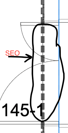

Hello,
I have the issue on my main floor that the curtain wall that was operated on is not showing a complete opening but on the second floor it is showing a complete opening. The solid element operation has work as it shows fine in 3D just not on the main floor plan. The cut plan is also at 1 meter and cuts through the objects that have the operation. Curtain Wall is used as curved wall.
Any help and ideas would be appreciated, Thank you.

The results of Solid Element Operations do not show in plan.
nikkik

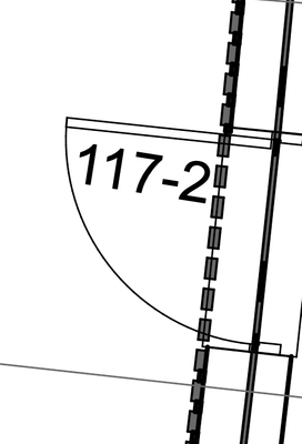

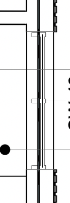

Sorry, forgot to include that it did work on plan view on the second floor. It was just the main floor that it did not show on. How would that be possible then?
Are you sure it is the result of the SEO you are seeing on the second floor?
I just tried an SEO on a curtain wall (version 25) and there was no change to the plan at all.
Pretty sure. I did the operation and it showed up on plan on the second floor that's why I was thinking it was a settings option as it showed completely on the second and only partially on the main floor. (version 26)
