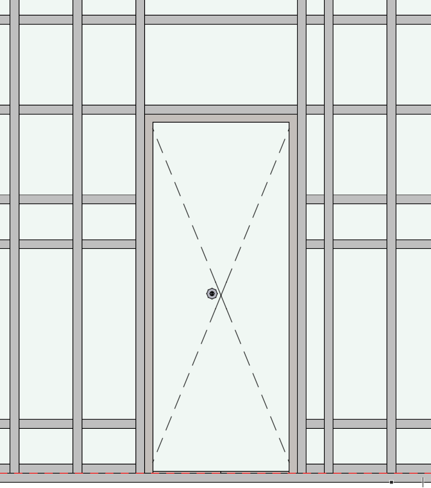

I have a  door in curtain wall but the central line between the doors doesn't appear in elevation. (see image below)
Does somebody know how to solve this issue?

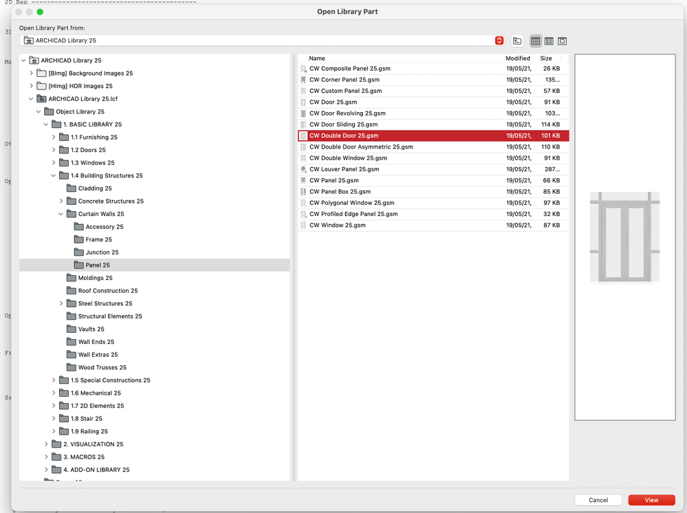

1. In Menu File / Library and Objects / Open Object. from Archicad Library 25 or whatever version you using in this case CW Double Door 25.gsm

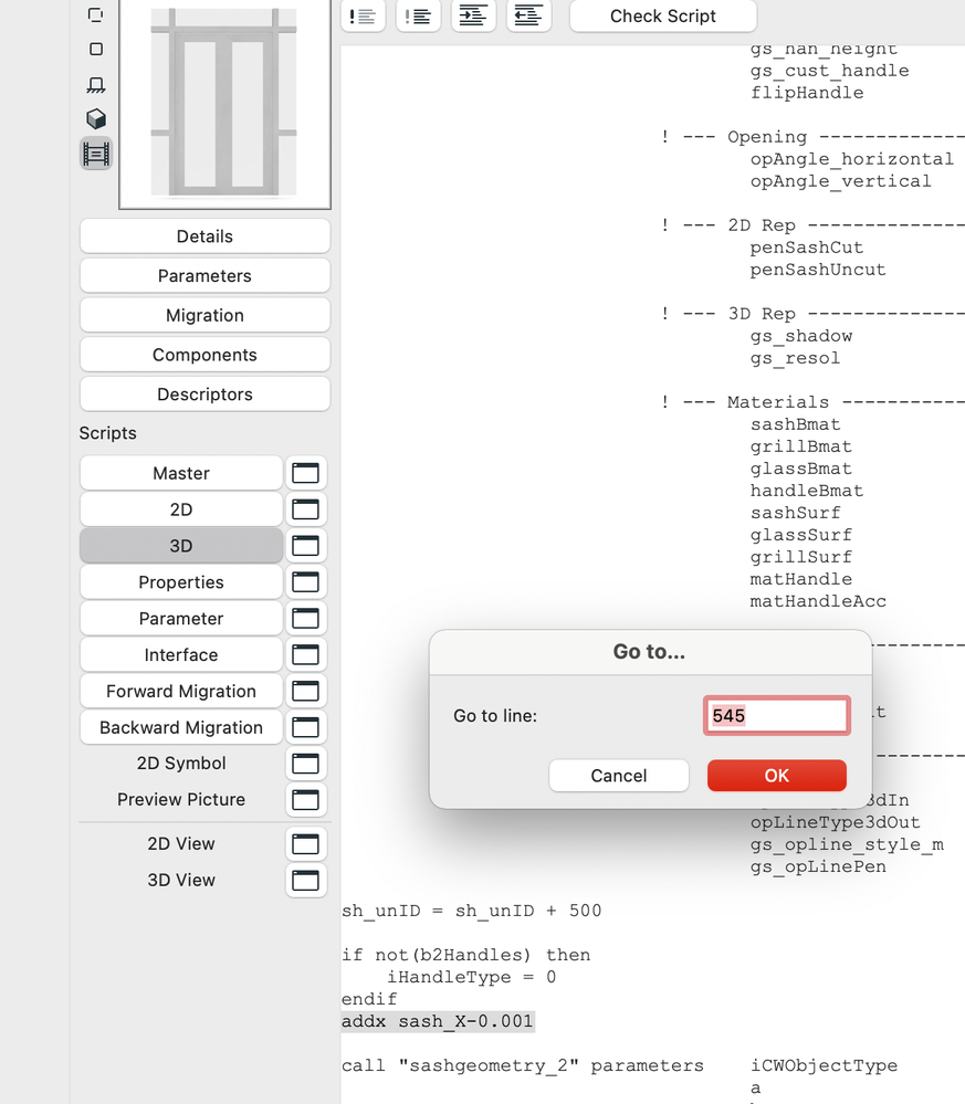

2. Open 3D script and go to line 545. there is original addx sash_x add behind -0.001 that will offset panels and live gap between them

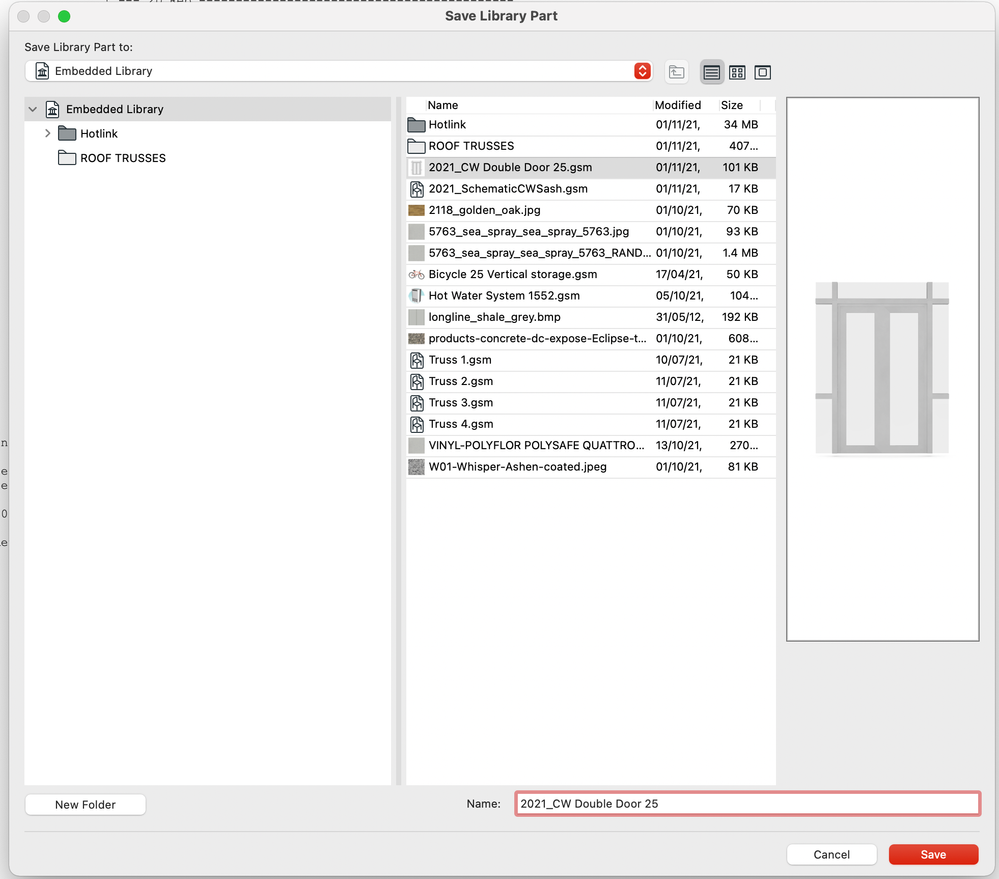

3. Save this object with different name in Embedded library and replace original with this new one
Your door should have now permanent gap between panels
