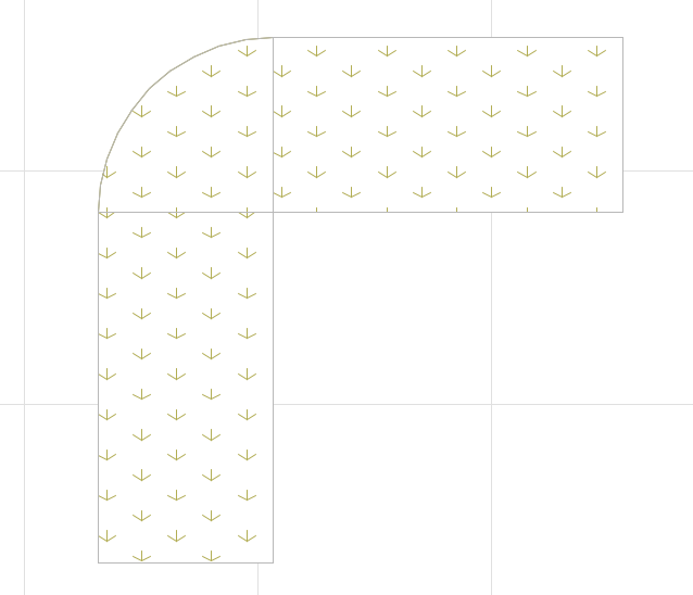

how can I make this ramp on Archicad12 ?
(the gray fill)
it's not a straight ramp neither a curve one...
I try the custom stair, but doesn't worked... I thought the mesh... but it didn't make a correct model...

Sorry mate, I wouldve used mesh tool
use line tool to draw the shape of the ramp
then select mesh tool and press space bar and click the line to make a mesh.
and elevate the points to create a ramp
the curve part should be the landing, which no need to edit the level
to elevate the up the upper part, to elevate down the lower part (please look at the little tool box)
done

I could make this way... but there is no thickness.
in the flat mesh there is... but when i changed the elevation, it's gonne...
Dwight
- You can make the mesh have thickness, but not uniform thickness.
--- You can convert the mesh surface into roof segments that will have uniform thickness.
-- We do have a ramp object
