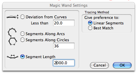

Is it possible to make part of the wall curved, but built of glass (like in the first sketch I attached)? I prefer frameless windows, can ArchiCAD subdivide them in segments (let's say 2m width each)? I tried the same space-click with a window tool, but it didn't work, and when I started putting windows manually, the process is totally uncontrollable, and displays me the message "The window extends behind the wall, would you like to keep it?" And I get just a bunch of messy windows everywhere (see attachment 2).

probably the best way to do this would be to do the glazing as a wall
just magic wand (space click) another (thin) wall onto the spline, but before doing this...
go to tools>magic wand settings... and change to
Amazing! What a brilliant piece of software and brilliant people here on this forum! I can continue working on the idea without worrying about its realisation. I can basically complete my building with these functions you described, with minor tweaks needed. Wonderful.
Thank you very much, Frédéric and Bill!
