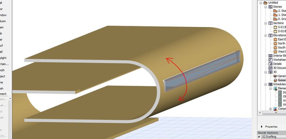

Hello,
As per attached image I want to insert curved Window in Curved Profile of Wall.
Wall is a Complex profile.
Is there any way except creating custom Window?
Regards,
Ratna

ratnabhirud wrote:
Hello,

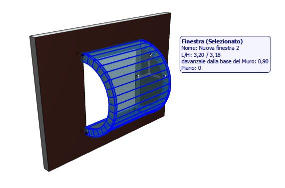

I don't think. I only know of one horizontally curved window (for "normal" curved walls), but never seen one vertically curved.
For a dirty result, you can try to make a curved CurtainWall, using the "invisible" option for the inner frames.
You can also save it as a window (an horizontal copy of it, laying in the the plan, with the glasses parallel to the x axis).

ratnabhirud
Thank you so much rocorona,
Yes, it is good idea that instead of inserting window in Complex profile, we can place curtain wall.
Thanks again for prompt reply.

ratnabhirud
Hi rocorona,
In this post you said that you can place curve window in Curved Wall,
Can you explain via inserting image.
For reference , I am attaching image what I need.
Can you help/
Regards,
Ratna
