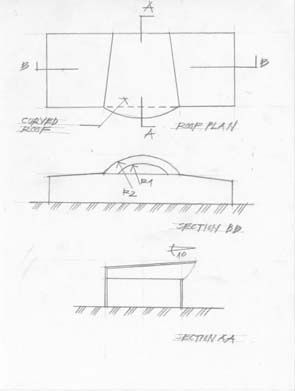

Curved & Tappered Roof
I want to make this roof as attached. please help me.
Thanks.

Thomas Holm
I'm not sure I've understood you right, but there is a conoid object (cone segment lying down) in the basic forms folder in the library. You could use that and then cut the protruding end using SEO with a sloping roof (or, to get the edge curve) a custom profiled wall as a hidden operator.
The rest is basic Archicad walls and roofs, look in the Help file.
Chris Grantham
You might look into the mesh to roof tool. This is in the Design-->Design Extras menu. Once you create the roof though it becomes pretty hard to manage as you will have a ton of little slices. For your roof plan you will probably have to use a fill to cover up all the crazy line work. Anyone else have any ideas?

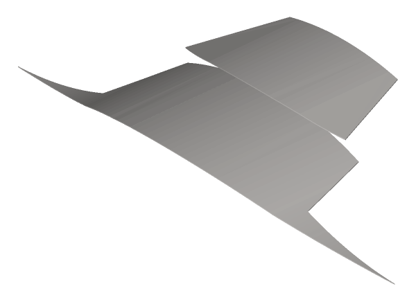

hi,
i'd like say thanks, i'm very happy, coz finally i've done the roof.
thanks to chris,thomas and this forum.
this is my roof i attach, i'm using add-on mesh to roof.
