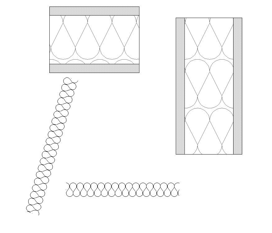

‎2007-08-28 04:30 PM
First question- when you guys put attachments in there messeges do you do it through photobucket or something similar, so you can get the "img"?
My archicad question:
I am having a hell of a time trying to get a batt insulation fill to fit in a 3
1/2" wall.
(It did work for a 4 1/2" wall which i did by total mistake"
I am making my own cause archicad's is just a criss cross.

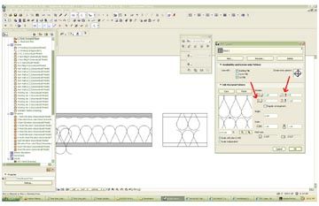

I have gotten as far as the attchement shows you, but I cannot get it to line up correctly, it is shifted so that the curved parts of the symbol are not at the top and bottom, but they are not even at any didstance that makes sense, they aren't shifted half or a quarter fo the way up. I have tried copying the pattern I want with all kinds of different shifts, I mean, cutting it in half and placing it on top of one another, etc. I know that probably makes no sense.
But, will some one look at it, you should be able to see my problem when you open the attchement.
Also, what is the purpose of the "X2" and "Y1" dimension options they give you, I changed Y1 around, and it seems to just offest half the symbol fill or something.
Can some one please help me, I have searched on here, done the wiki thing, done the archi cad help thing.....

‎2007-08-29 05:40 AM
Because cut fill origins cannot be manipulated within walls, trying to generate batt insulation in a wall is not best achieved by fills. And Because GS won't give us symbol lines in our composites, we are left with rather an ugly workaround (again).
We are lucky enough to have been supplied with an insulation library part that we can stretch over our walls. It's quite a nice little object, but it is a workaround nonetheless.
Cheers,
Link.

‎2007-08-29 09:59 AM
Jesikuh123 wrote:Be careful. I did try this once and the size of the exported DWGs were enormous. This was because the circles were rendered as small lines. Maybe things are better now.
1/2" wall.
And yes, getting things to line up was next to impossible.
