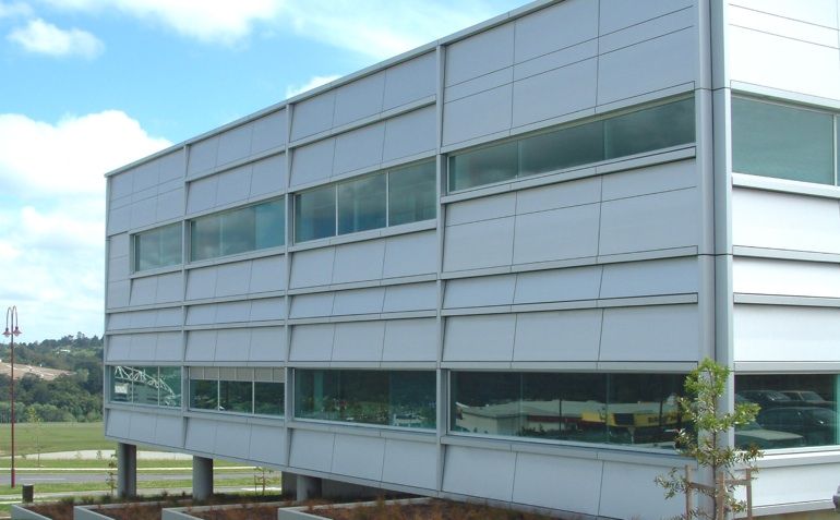

Is it possible to create a curtain wall - custom panel box that is slanted.
Here's an image of a facade that we're using as a reference.
1 Solution
Yes, you can create custom Curtain Wall Panels, but it might require some GDL knowledge.
You can model your panel on the Floor Plan, select it and use the File\Libraries and Objects\Save Selection As\Curtain Wall Panel menu command.
I cannot offer more advice since I have not worked with this command before so I am not familiar with its intricacies, if there are any.

Just like Laszlo described. Model the panel with suitable elements, select the elements, and save as curtain wall panel. The panel will be selectable in curtain wall settings, or in 3D then modify-mode is on. Panel will stretch to the size of a given frame (see pic). You might have to make a few panels to achieve what you want.
In the pic I made 9 roofs with small gaps between them. Custom panel is the one which lies horizontal in front of the curtain wall.
