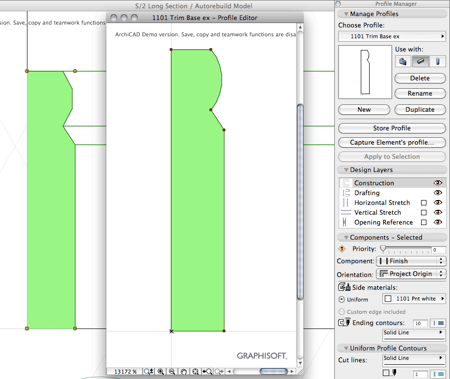

Any suggestions as to how I could edit the number of nodes created from a custom profile that has multiple curves. The profile was originally saved with arcs, howver when saved and subsequently re-opened there are mulitple nodes forming the arcs which then translate to extra linework in elevation. Is there a setting that I'm missing?

Thanks all in advance for attempting to help with the resolution of this issue. I have attached a graphic to help explain. I have created a custom profile in this case eave profile foam trim that has been applied through the wall tool. When a change is needed to be made to the profile, I would access the profile through the capture profile command. Then make the adjustment and apply to selection. Could the process be the problem?
Here's the graphic.
Yes, when you capture the Profile of a wall/beam/column It will "simplify" the curves by splitting the arcs into straight lines. The method it will use for the calculation is the one in your magic wand settings.
If you simply duplicate the profile or crate a new one you will not have that problem.
eminem wrote:
The original profile was created with arcs, saved and applied to the location as a wall tool. Once the model is recaptured to make alterations or the model refreshed, segments replace the original which then translate to linework as presented in elevation.
Don't recapture the profile to edit it. The arcs will get simplified into segments in the profile manager as you have seen.
The easiest way to manage profiles is to open the profile manager, select the profile from the list, and modify the original profile there. When you have finished making the changes, press the 'Store Profile' button. Go back to the floor plan and all elements with this profile will automatically update.
The profile will still be segmented in elev/section but it won't produce the extra lines you refer to, and also if you go back to the profile manager, the arcs should still be smooth and won't need re-editing again.
