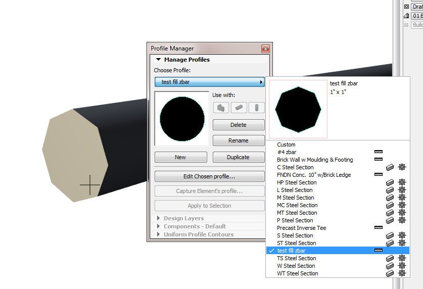

It makes no difference for me. I have tried capturing the profile, drawing the profile in floor plan, copy and paste it into the profile manager, and drawing a new profile in the manager. I have set the magic wand settings to as small as they will go ( 3/64", 360, 25/64" ) and get the same result.
I am trying to make a simple 1/2" dia. piece of rebar. I can't get is smooth.
...but rebar isn't smooth, though the rendering algorithms will make it appear that way. The only place the faceting will show is in very large scale sections. Is this really a problem?
