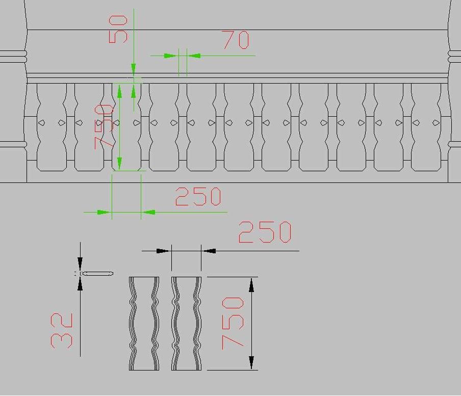

I try to make this custom railing, but I am completely stuck. How can I make a railing like this based on the 2D drawings in AutoCAD?
Any help is greatly appreciated!

It's a bit hard to tell from the drawing whether those are flat or turned balusters.
If they are flat the simplest thing is to model them with slabs and save as library parts. They could also be done with profiled walls or beams (the length would be the thickness of the baluster.
If they are turned one option is to make them with profiled walls (they will curve - beams do not). They will probably need to be made hollow as they likely won't turn around a zero radius. You could also use an add-on such as Objective or Archiforma. Or you could write them in GDL.
The top and bottom rails are trivial to make with profiles.
By the way, assemblies such as this are typically called railings or (more properly) balustrades. Fences are freestanding in the landscape.

The balusters are flat, 32 mm thick, both sides with curved details. I hope the attached picture is easier to understand.

So you want to model the groove inset from the edge too?
The best way is probably to start with a slab, 32mm thick, in the shape of your panel. Set up a Custom Profile wall the shape of the rebate (groove) and offset it from the edge of the slab, then SEO Subtract the profile from the slab. (You would need to do this for both sides if it needs modelling front and back). View the slab with grooves removed from what will be the top in 3D window and save as an object.

The profiled edges on the flat balusters definitely add to the complexity of the task. Probably best to make one, save it as a library part and build up the balustrades with multiple copies of the balusters and profiled beams for the rails. These could then be grouped and copied around.

Finally I got it right! It turned out to be a minor detail making me alot of trouble! The AutoCAD profiles where not good enough, lines where corrupted by glitches < 1 mm making the Custom Profile wall with the shape of the rebate corrupted.
Solution: Fix the AutoCAD drawing and start all over again.
