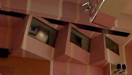

The wall surfaces appear to be planar. If this is true you can use sloping walls which should join properly in most cases. You may need to use some SEOs as well for the tops and any parts that won't join quite right.
If there are simple curves (circular or spherical) you can use a profiled wall.
If you have complex curves and have AC15 then the shell tool is probably best.
