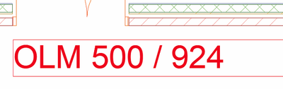

I have managed to make a request for the door leaves width via GDL on a label object.
As you can see on the screenshot bellow, the label shows the door leaves width separated by "/" and I would like to change it for "x".
Is there a way to change that character for something else?
Cheers.

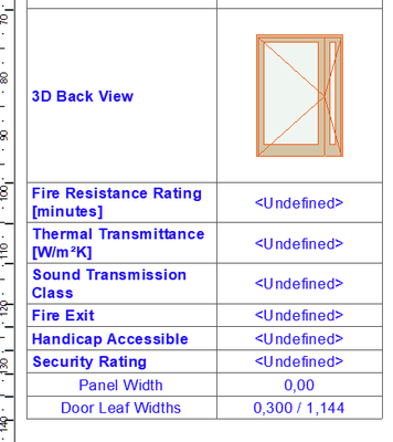

It is comming automatically as far as I know, because if I add that same parameter to the door schedule it shows the same character. I think that is added by that specific parameter and not by the label, but not sure.
This is how it shows the parameter on the schedule:
If I try to override it by simply writting an "x" it goes back to "/", but I was thinking that maybe in GDL I could force the character override. I'm clueless.
Cheers.

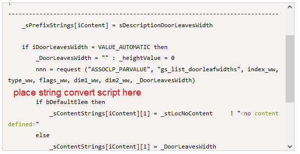

I was trying your suggestion of splitting the name, but honestly I'm scratching my head on how to proceed with it. The name splitting should happen in the 2D script tab (I think), and this is my code in it:
"getStringDoorLeaves":
	_sPrefixStrings[iContent] = sDescriptionDoorLeavesWidth
	if iDoorLeavesWidth = VALUE_AUTOMATIC then
		_DoorLeavesWidth = "" : _heightValue = 0
		nnn = request ("ASSOCLP_PARVALUE", "gs_list_doorleafwidths", index_ww, type_ww, flags_ww, dim1_ww, dim2_ww, _DoorLeavesWidth)
		if bDefaultElem then
			_sContentStrings[iContent][1] = _stLocNoContent 	! "<no content defined>"
		else
			_sContentStrings[iContent][1] = _DoorLeavesWidth
		endif
	else
		_sContentStrings[iContent][] = sValueDoorLeavesWidth
	endif
return

Solution
Let's try this.
Might not be the best solution but I think it will work.
You request the door leaf value from the parameter 'gs_list_doorleafwidths' and then assign that value to the parameter '_DoorLeavesWidth'.
You need to SPLIT that parameter to get the leaf sizes and the separator.
This will give you a number, text, number.
The numbers you have to convert back to a text string and then join them all back together to re-create the '_DoorLeavesWidth' parameter but now with your new separator.
So this is what you want...
n = SPLIT (_DoorLeavesWidth, "%n/%n", n_leaf1, s_sep, n_leaf2)
s_leaf_1 = STR (n_leaf1, 3, 0)
s_leaf_2 = STR (n_leaf2, 3, 0)
_DoorLeavesWidth = s_leaf_1 + " x " + s_leaf_2
If you place it in your script here, I think it will work.
I do have that asymmetrical door object, but I see no way of changing the separator in the door parameters itself.
So I think the above is the best bet.
Fantastic, thank you so much for your time and support 🙂
I did a minor adjustment since the second value wasn't returning a float value, I added ^ in the %n, so it looks like this now:
n = SPLIT (_DoorLeavesWidth, "%^n/%^n", n_leaf1, s_sep, n_leaf2)
And everything is up and running.
The bigger door leaf has this value:
If I don't add the ^, the result in the 2D looks like this:
After adding the ^, looks like this:

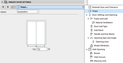

About the door object, the parameter can be found here:
Cheers.
