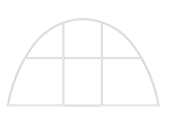

Custom window not appearing in 3D/Section views
I have created a custom window using the directions found on an archiwiki link to fit within a catenary arch i developed.
I created the glazing using slabs, the frame using walls and then placed an additional slab of the same shape on top of these objects, changing the ID to 'WALLHOLE'. I switched to the top parallel view in the 3D window and saved the objects as a window. The option button was not available, where you can tick the 'editable GDL script' box (incidentally this option has never been available when I have created a custom opening but hasn't been a problem so far).
Going back into plan, the window is applied no problem and is visible. However when switching to 3D or section views, it is neither visible nor selectable.
I tried using a different window with a plain frame and no mullions which i had created a week or so ago and that does appear in 3D but only the glazing is visible. Hopefully the pictures can explain. There are 3 similar types of these windows and the simple one is on the right.
Can someone tell me where i'm going wrong? Any help would be much appreciated!

Try a couple of things:
1. "COMMAND-T" to open the symbol and see if it shows up in the 3D preview
2. Open the symbol and see if it shows up in the symbols 3D window
If those are OK
3. See if it's being excluded by the renovation filter - or -
4. DOCUMENT > PARTIAL STRUCTURE DISPLAY
It's frustrating but there will be a logical reason somewhere!!
Good luck.

Hi Cameron,
thanks you for your reply. Everything you suggested was in order but I just found out what the problem was!
When I moved the arch, which is a custom profile beam, away from the opening, the window reappeared. This made me realise that I previously used Solid Element Operations to subtract with a downward extrusion an opening in the wall below the arch (probably the wrong way since I've learnt how to create custom openings) so I cancelled the operation and the window appears correctly in all views!
Thank you anyway, my signature has been updated as requested!
